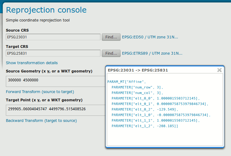

There is a demo / tool you can use to look at the transformations involved: Reprojection Console.
The specific library is http://geotools.org which makes use of an EPSG database to setup the transforms shown in the tool above. There is a lot more detail in the GeoTools user guide, and of course the source code!
