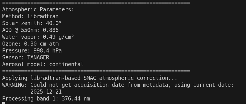

Integration of libradtran input generation into SMAC, getting there. Need to get timestamp in, it is using today’s date as satellite acquisition date…

Hi, try GitHub - YannChemin/i.hyper.smac: GRASS GIS AddOn to apply atmospheric correction using SMAC on raster3D imagery imported by i.hyper.import

I am using Tanager Agri sample of Kanpur (India) for i.hyper.smac

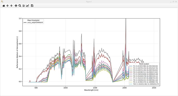

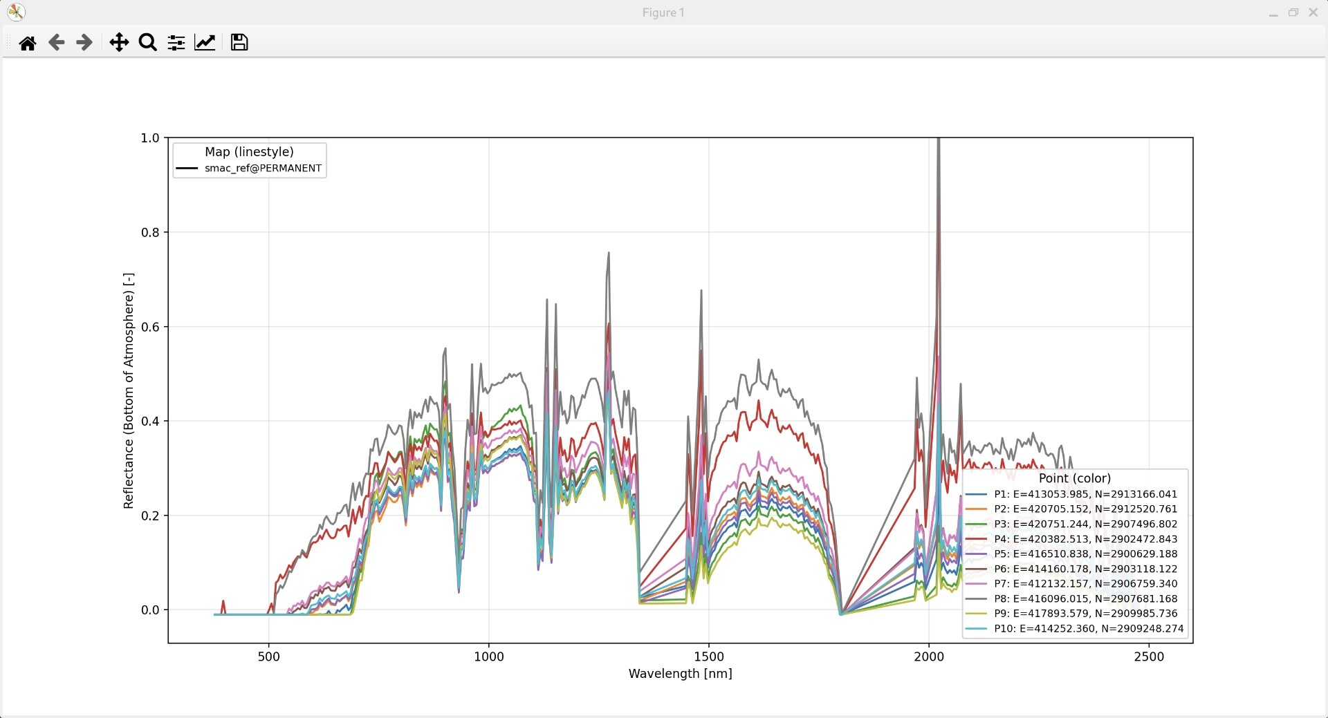

Still some issues, but getting better
