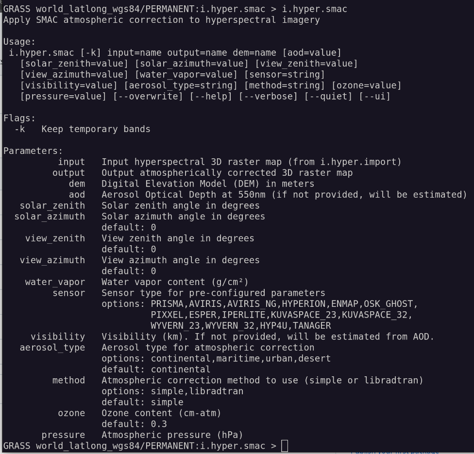

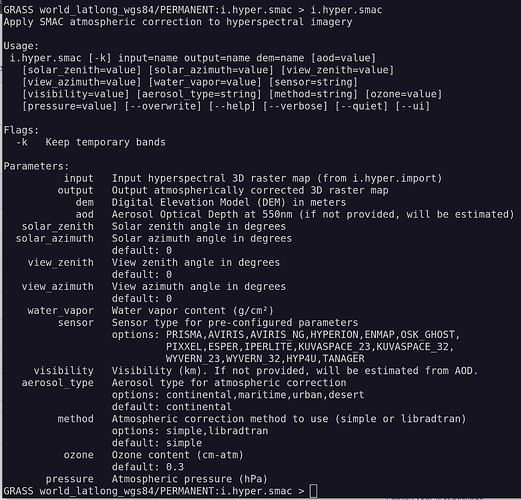

First draft of i.hyper.smac

so there is no metadata transferred from basic_radiance pertaining to atmospheric correction requirements:
1 - Sun Zenith Angle
2 - Sun Azimuth Angle
3 - Satellite Zenith Angle
4 - Satellite Azimuth Angle
Could you look into making them available as metadata, so atmospheric correction Algorithms can work? Number 3 might be an array 1D or 2D, or just an average, to check.
