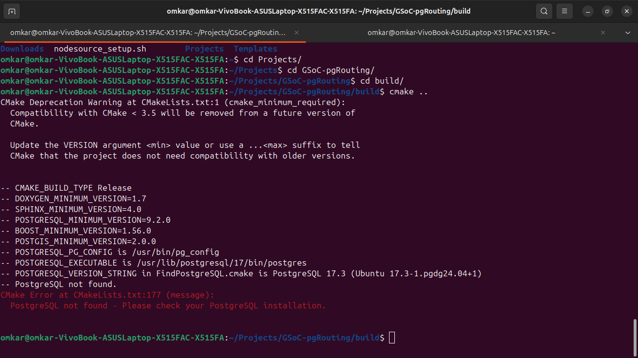

I am facing issue in compilation of GSoC-pgRouting
Screenshot from 2025-02-15 02-29-31
How to resolve this
Hi @om3904 ,
Please confirm that all requirements are installed. The compilation error occurs because PostgreSQL isn’t being recognized. Make sure PostgreSQL (including its development headers/libraries) is installed, then re-run the build steps. Thanks!
@om3904 I since for Ubuntu, you need to do:
apt install postgresql-server-dev-17
As detailed in our ci workflow - pgrouting/.github/workflows/ubuntu.yml at main · pgRouting/pgrouting · GitHub
You’ll also need postgis. Anyway just follow the workflow and make sure you have all those things it installs around there installed.
