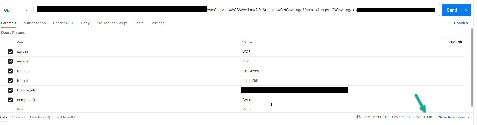

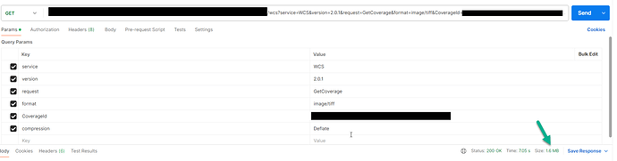

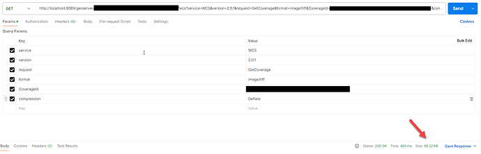

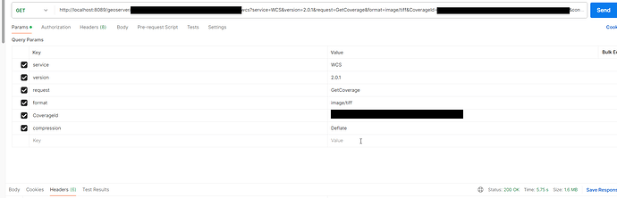

I have noticed incomplete/corrupted tiff files from WCS GetCoverage requests with compression Deflate after updating GeoServer to newer version.
Older version:
After update:
Requests at version 2.24.1. and under work fine
Requests at versions 2.25.1. and 2.26.0. return corrupted files

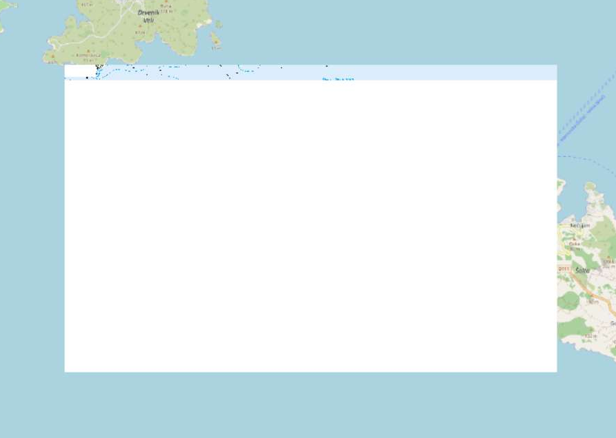

If I remove compression or put it to something like LZW it produces working tiff file but since we are using WCS to fetch geoTiffs for reupload to another GeoServer instance and they can get quite big we need to compress them.
LZW is maybe, but for some reason reuploaded geoTiffs have much slower WMS requests.

we use deflated images on a daily basis without issues… what’s the specific structure of them, can you share a gdalinfo over a file?

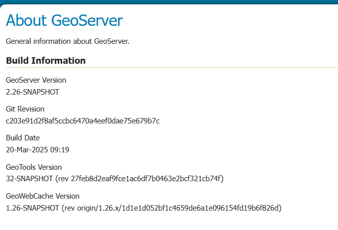

Also, there has been updates to imageio-ext in the last few days, wondering if any of those could help: I’d suggest trying out a nightly build of the 2.26.x series (2.25.x did not receive the update, so probably not worth trying).

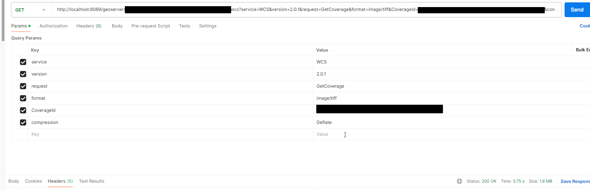

Thanks for answers, I tried Index of /geoserver/2.26.x/ → geoserver-2.26.x-2025-03-20-bin.zip and its working, GetCoverage with compression deflate gives same results as version 2.24.1
