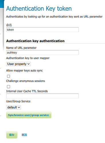

3、add filter,
1) select AuthKey - Authenticates by looking up for an authentication key sent as URL parameter
2)name: token
3)Name of URL parameter: authkey
4)Authentication key to user mapper: user property
5)User/Group Service: default
6)click Synchronize user/group service button, on the top shows “Synchronized successfully by adding 1 keys” with green background
7)click save button

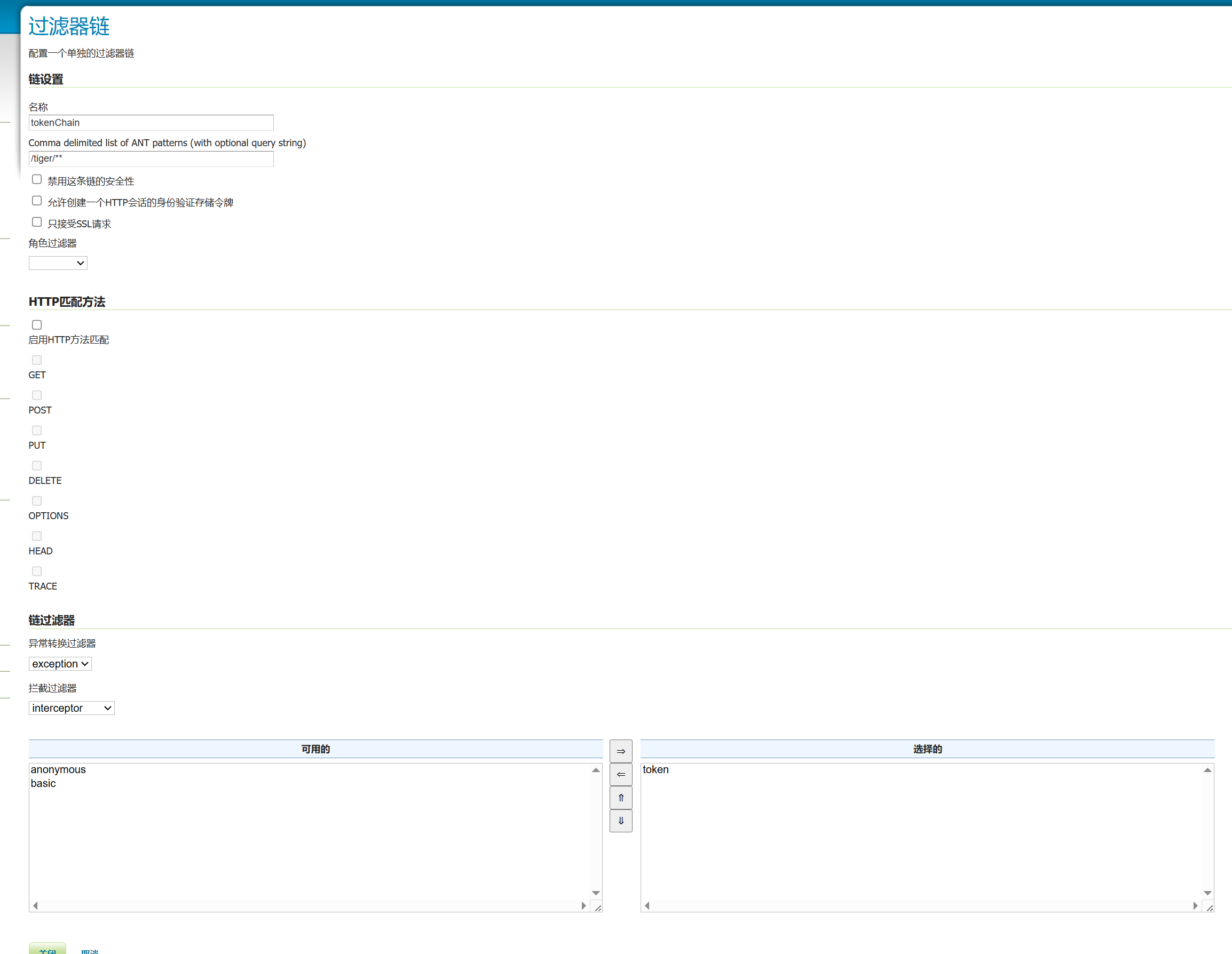

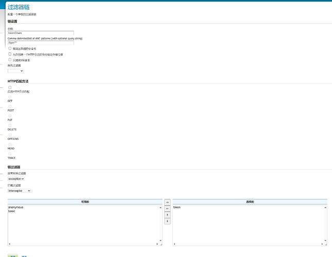

4、add chain
1)name: tokenChain
2)Comma delimited list of ANT patterns (with optional query string): /tiger/,/sf/
3)move “token” to the right list
4)click close button

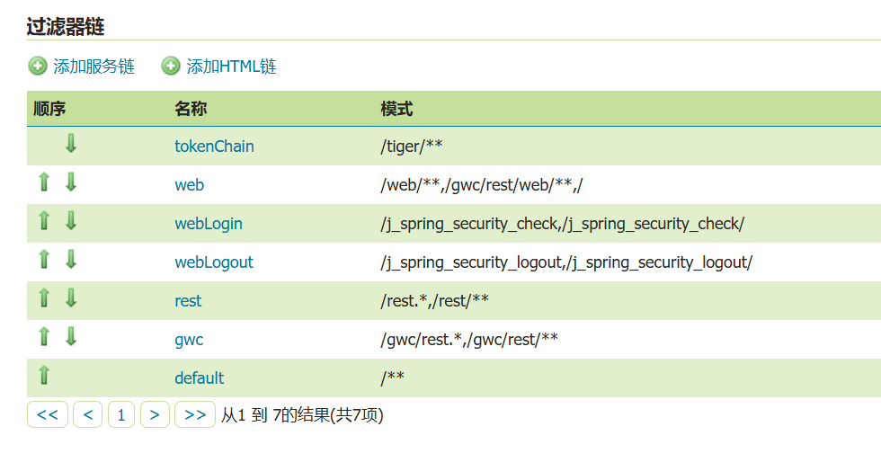

5、move tokenChian to the top
6、click the save button
7、restart tomcat and geoserver
8、nothing happend,the server still can be visit without authkey
