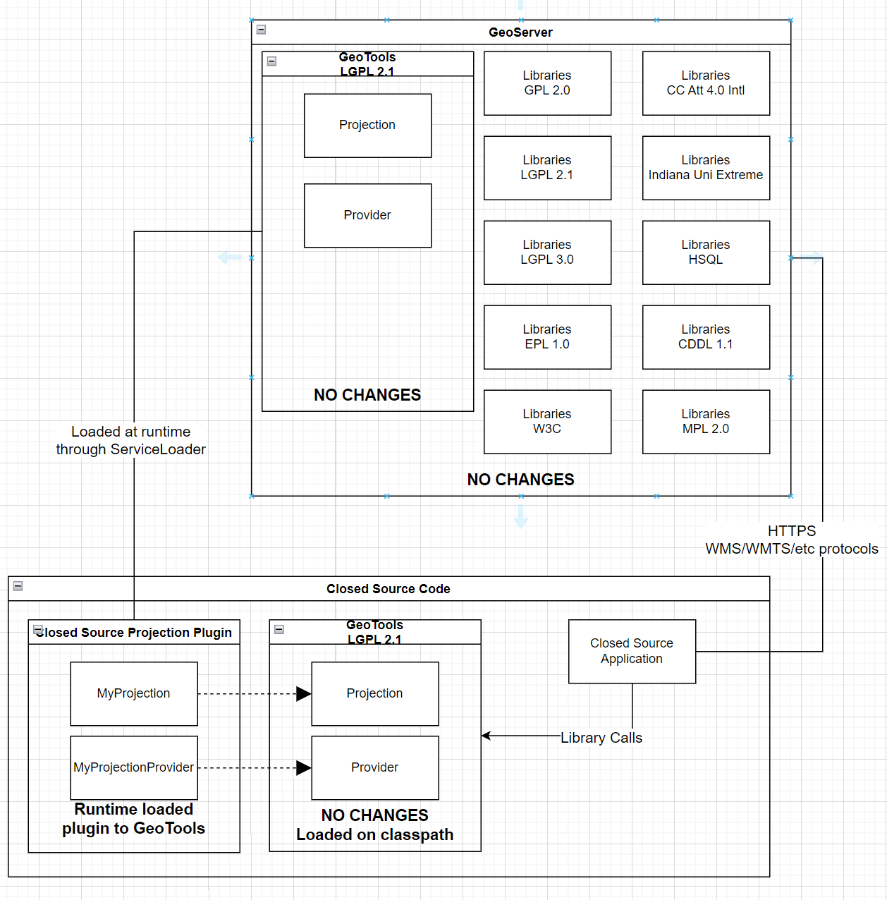

Just to clarify - if I create something like the below, and I distribute two bundles/installers/whatever (one containing an unmodified GeoServer, the other containing my code), then I am OK from a licensing perspective without releasing my source code?

Yes you are fine, some details to correct your diagram. You drew the compile time diagram, what what you want to consider is the distribution (what people download) diagram since that is what the license is about.
  • GeoServer : Free Software
    You can move GeoTools into the this box as it is included in GeoServer download.
    As long as you have no changes to GeoTools you are not distributing it, geoserver.org is.
  • Closed Source Code: Remove GeoTools box from here - you are only using GeoTools library at compile time, not distributing this to your end user.
The critical check is what your end-user receives:
  1. One bundle downloaded from geoserver.org.
    End user have the ability to look at all the source code of everything included and compile it themselves or perform a security audit.
  2. One bundle from you with some closed source MyProjection and MyProjectionProvider classes, that will call over to your closed source application using some library API calls.
