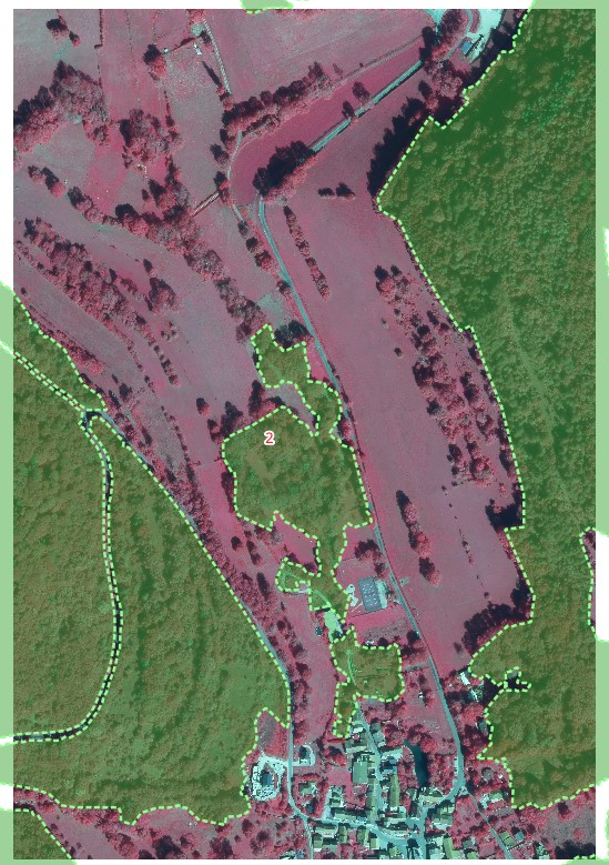

I’ve attached below a screenshot that allows you to display an input raster image (here a multispectral Spot6/7 satellite image) and the mask layer (vector forest DB mask) to better visualize the context:

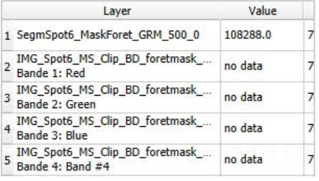

When i tried clipping my multispectral SPOT6 image with my BD FOREST mask (clip a raster with a masking extent coverage) by setting the value -999 (16-bit signed output) for the no data values during clipping. This worked. But when I try segmentation with the OTB GRM tool on this image, the process isn’t ignored in the areas for which I had assigned no data values. The tool segmented the entire image. I share an additional screenshot showing the pixel values in an area of no data values. The values are indeed set on no data values for the multispectral SPOT6 input image. And you can clearly see that it assigned a value to my segmentation result. The process has been done for no data values also :
