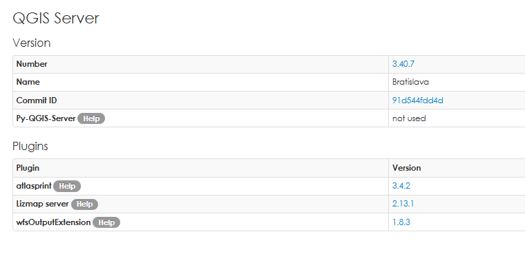

Hello there…I’m still using LWC 3.8.2, but last day I received the mail about the official release of the 3.9 version and with the annotation that the py-qgis-server from this version on is mandatory instead of optional…i used Docker to start the first tests before upgrading, but I’m stuck in the part that the LWC recognizes my py-qgis-server (http://:8080/ows)
At server info I get this:
Modules
No module installed
QGIS Server
QGIS Server is correctly installed and returns the expected response for OGC requests.
We cannot get the details about your QGIS Server installation (version, plugins, etc.).
You must check that the following steps are done :
  1. QGIS Server is above or equal to 3.28
  2. The Lizmap QGIS server plugin is installed on the server with a version above or equal to 2.10.1
  3. The URL to reach QGIS server is correct in your administration panel
  4. The URL to reach the Lizmap API on QGIS Server is correct in your administration panel, if you use Py-QGIS-Server
  5. Your Lizmap Web Client logs does not contain any warnings about reaching QGIS server
  6. The environment variable about the Lizmap server plugin described in the documentation link below is correctly set in your configuration
  7. Your QGIS server logs does not contain any warnings about the Lizmap server plugin (at QGIS server startup and when loading this webpage). You might need to increase debug level.
On the container:
root@8c0c88e43ab2:/# qgis-plugin-manager list
QGIS_PLUGINPATH set to /usr/lib/qgis/plugins
QGIS version : 3.40.7
List all plugins in the directory set by environment variable : /usr/lib/qgis/plugins
| Folder :down_arrow: | Name | Version | Flags | QGIS min | QGIS max | Author | Folder rights | Action :warning: |
|atlasprint |atlasprint |3.4.3 |Server |3.28 | |3Liz |root : 0o755 | |
|lizmap_server|Lizmap server|2.13.1 |Server |3.28 |3.99 |3Liz |root : 0o755 | |
I think I’m missing the path for the projects, but I have the same settings as in my QGIS server running on Ubuntu 24.04:
Can anyone give me a hint?

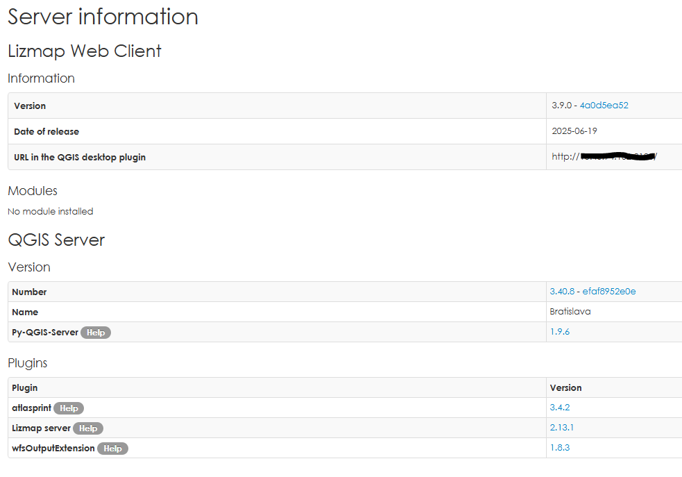

Back again…my problem was trying to understand the role of a qgis-server installed from packages of Ubuntu 24.04 with the new py-qgis-server…like I said, I was trying to run LWC from a docker container with a custom image made by me…but now I have successfully deployed (in the same Ubuntu 24.04 server a py-qgis-server instance:
I had some trouble making the py-qgis-server running as a service, let me share with everybody what did it for me:
@ /etc/systemd/system/py-qgis-server.service file:
[Unit]
Description=PY-QGIS server
After=network.target
[Service]
Type=simple
ExecStart=/opt/local/py-qgis-server/bin/qgisserver -c /srv/qgis/server.conf
ExecReload=/usr/bin/qgis-reload
Environment=QT_QPA_PLATFORM=offscreen
KillMode=control-group
KillSignal=SIGTERM
TimeoutStopSec=10
Restart=always
StandardOutput=append:/var/log/py-qgis-server.log
StandardError=inherit
SyslogIdentifier=qgis
EnvironmentFile=/srv/qgis/config/qgis-service.env
User=root
LimitNOFILE=4096
[Install]
WantedBy=multi-user.target
@ /srv/qgis/config/qgis-service.env file:
LC_ALL=en_US.UTF-8
LANG=en_US.UTF-8
DISPLAY=:99
QGIS_OPTIONS_PATH=/srv/qgis/
QGIS_AUTH_DB_DIR_PATH=/srv/qgis/
GDAL_CACHEMAX=2048
QGIS_SERVER_CACHE_SIZE=2048
QGIS_SERVER_LIZMAP_REVEAL_SETTINGS=TRUE
QGIS_SERVER_FORCE_READONLY_LAYERS=TRUE
QGIS_SERVER_TRUST_LAYER_METADATA=TRUE
QGIS_SERVER_APPLICATION_NAME=py-qgis-server
QGIS_CUSTOM_CONFIG_PATH=/srv/qgis/profile
QGIS_SERVER_PARALLEL_RENDERING=true
