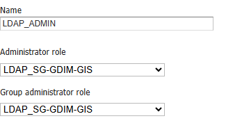

Lookup to the roles appears to be handled correctly, have added the LDAP role into rest.properties and this then appears in the log trace. I am a member of LDAP_SG-GDIM-GIS and this is also declared as admin

Swapping the provider chain around so that the LDAP user is above default doesn’t deliver a good result. Hierarchical group search on/off doesn’t seem to impact either. Have tried using the user@domain and DOMAIN\user syntax for logging in, still get a 401.
