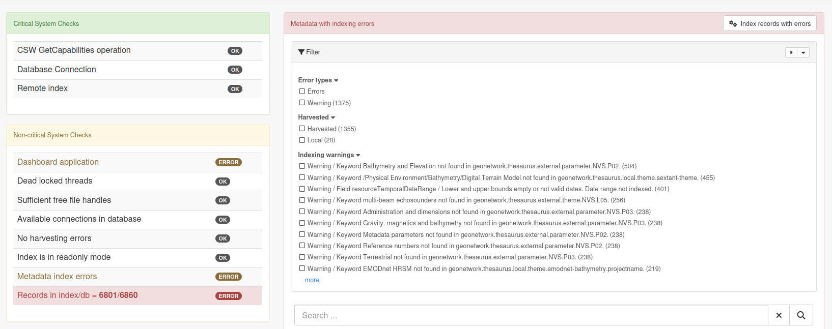

Currently evaluating GeoNetwork, with docker image version 4.2.8, there are apparently several thesauri or keywords missing when harvesting from the EMODnet INSPIRE catalogue, as indicated by warnings on the status page (see screenshot below).
There is only one thesaurus loaded by default in the docker image, and adding the GEMET - INSPIRE themes thesaurus (shown below) only fixed some of the warnings.

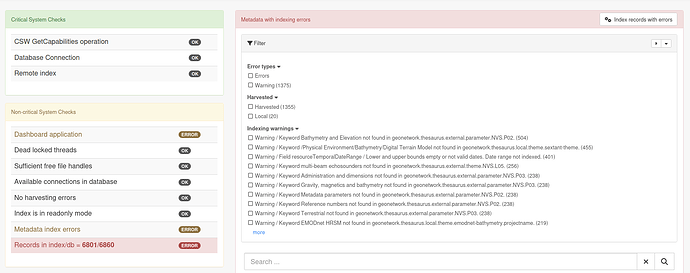

When uploading the INSPIRE theme register, it is listed as “GEMET - INSPIRE themes v1.0” (see screenshot 2).
Does this already contain the GEMET thesaurus, or just a part of it?
