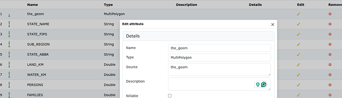

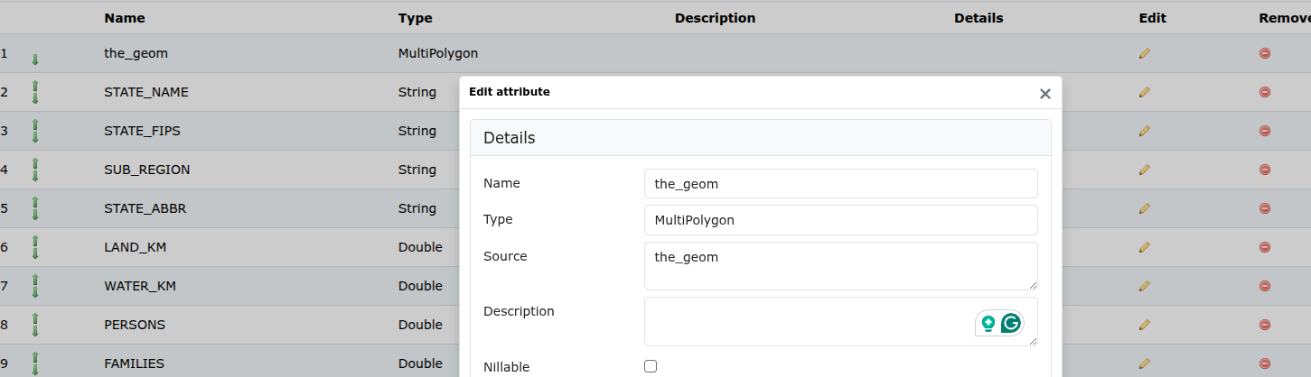

While attributes don’t have a title, they can have a description (enable attribute customization):
If the user is careful to enter a short description, it could well work as a “title” too… The alternative is to add a proper title in there too, for OGC API usage (this is a larger modification) of course, but it would be better from a long term perspective, as one day the title might show up and the description would then have to used for the same named schema property.
