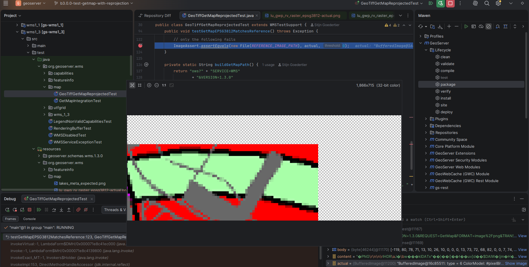

After migrating from GeoServer 2.27.4 to 2.28.4, we noticed that GetMap requests on raster data with reprojection causes the PNG responses to contain an offset. The problem also occurs with GeoServer 3.0.0.
The screenshot below visualizes the problem. The BufferedImage is not aligned with its origin.
I have no clue what could cause the issue. It may be a specific bug related to the Belgian reference systems (EPSG:31370 > EPSG:3812). In ground units, the shift is about 90m.The issue also occurred requesting coordinates in (EPSG:31370 > EPSG:4326). The problem only occurs with raster data (GeoTiff) not with vector data (PostGIS).
This testcase reproduces the issue. It succeeds on 2.27.4, but fails on 2.28.4 and 3.0.0
https://github.com/stijngoedertier/geoserver/commit/2ce35a3c7ec3112e3dfaf8407468f9f5dedeb382

Thanks for reporting this, @skalesse . It may be related. Nonetheless, I did some more testing and I confirm that the issue also occurs without bd72lb72_etrs89lb08.gsb NTv2 grid shift file on the class path:
  • I removed the jar containing the gsb file from our installation binary
  • I redeployed 2.28.4
  • I confirmed in the Reprojection Toolbox that the GSB-based transformation was no longer available
  • I see that GetMap WMS output still produces the offset in the output
