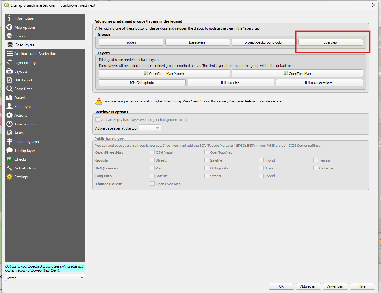

maybe I am just missing it - but is there now overview map in LWC that shows the current map-extent in its broader spatial context?
Indeed, this is completely missing in the documentation!
Clicking on “overview” in the baselayer menu will add a group. You can add layers into that group - those will be rendered in the overview map.
Would be awesome if you report it on GH that this is missing in the docs! :hugs:
