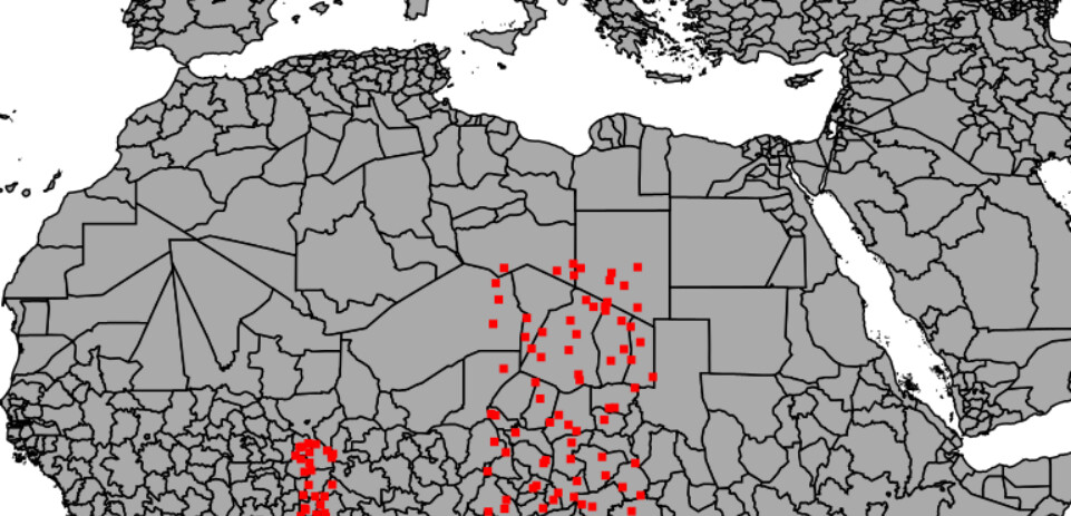

The top image is a png using OpenLayers and the bottom image is a WMS JPEG. The images were made with the same data points so it was expected that the red squares would be in the same place in both images.
Wow that is quite the change, as the projection has changed I expect much more than the image format is different between the two requsts - do you have the GetMap URLs submitted?

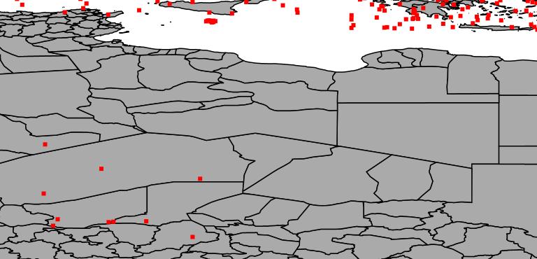

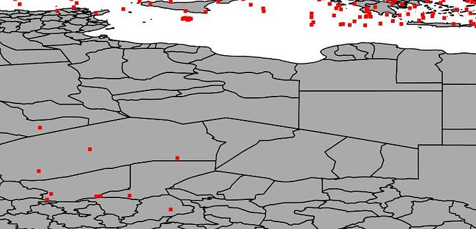

https://vanity.dodiis.mil/api/geoserver/wms?service=WMS&version=1.1.0&request=GetMap&layers=mrs:AdminSubdivisionSurface_VW_500m,mrs:unit&bbox=6.568%2C9.388%2C26.406%2C38.328&width=768&height=370&srs=EPSG%3A4326&styles=&format=text%2Fhtml%3B+subtype%3Dopenlayers&KeyId=694a05e5-21de-4e28-922a-5d85f2f79723
https://vanity.dodiis.mil/api/geoserver/wms?service=WMS&version=1.1.0&request=GetMap&layers=mrs:AdminSubdivisionSurface_VW_500m,mrs:unit&bbox=6.568%2C9.388%2C26.406%2C38.328&width=768&height=370&srs=EPSG%3A4326&styles=&format=image%2Fpng&KeyId=694a05e5-21de-4e28-922a-5d85f2f79723
https://vanity.dodiis.mil/api/geoserver/wms?service=WMS&version=1.1.0&request=GetMap&layers=mrs:AdminSubdivisionSurface_VW_500m,mrs:unit&bbox=6.568%2C9.388%2C26.406%2C38.328&width=768&height=370&srs=EPSG%3A4326&styles=&format=image%2Fjpeg&KeyId=694a05e5-21de-4e28-922a-5d85f2f79723

That looks a normal box range with EPSG.4326. So my next question is how you have the layer of dots (I assume mrs:unit) configured? What is its SRS and SRS Handling?
You should also be able to look at what request OpenLayers is making, to determine what parameter is being used to get the correct visual on screen.
