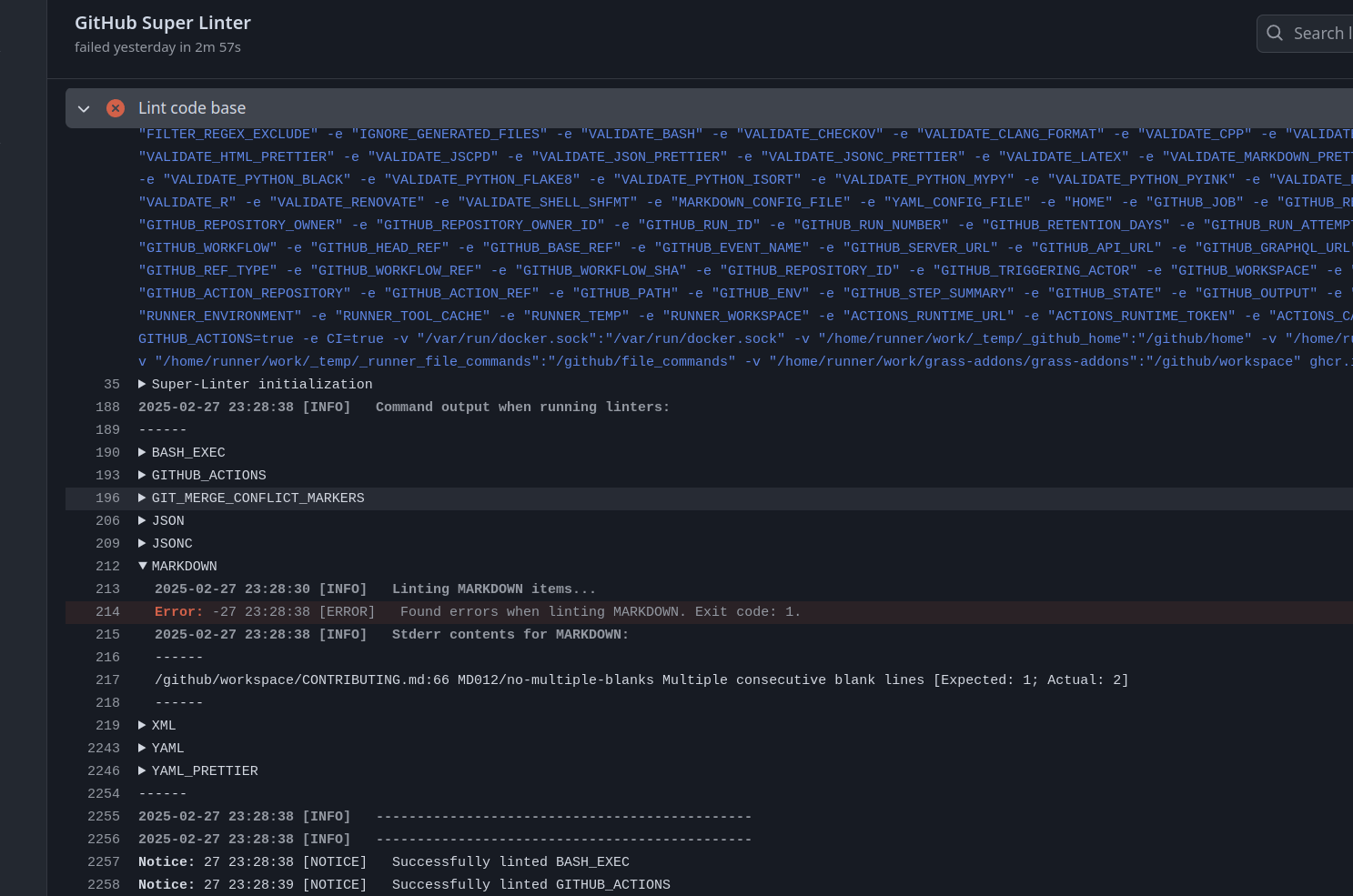

Anna, I have a question about what happens when you ignore the pre-commit check result if it failed. I just tried a PR for a very minor change to CONTRIBUTING.md, and the Markdown check failed. Even looking at the log, I couldn’t really tell why, and it renders fine in Github, so I squashed and merged it anyway. But Edouard made a comment that the error will now be shown again after each commit? How do I rectify this? And, if it’s sometimes “OK” to ignore minor pre-commit errors, how would I prevent that situation from happening again?

The markdown file had multiple extraneous newlines between paragraphs. Super-linter shows it in its logs. We could help you when you’re not sure
The CI does not prevent you from merging it even with a failure (in addons). I guess the expectation is that contributors with write access will check that and fix it. But maybe we should change the github setting to not allow merging in that case?
Here is the problem:
/github/workspace/CONTRIBUTING.md:66 MD012/no-multiple-blanks Multiple consecutive blank lines [Expected: 1; Actual: 2]
