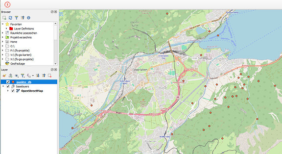

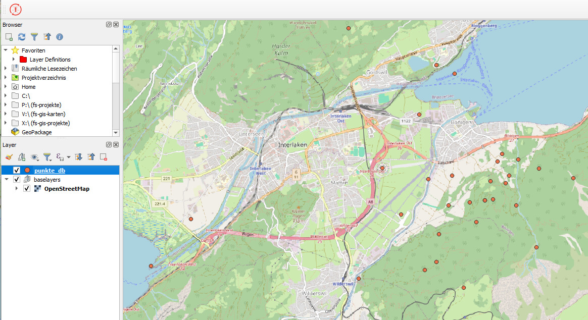

I have created a test project with only the geometries layer (points) and in qgis they look like this:

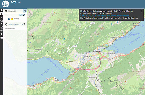

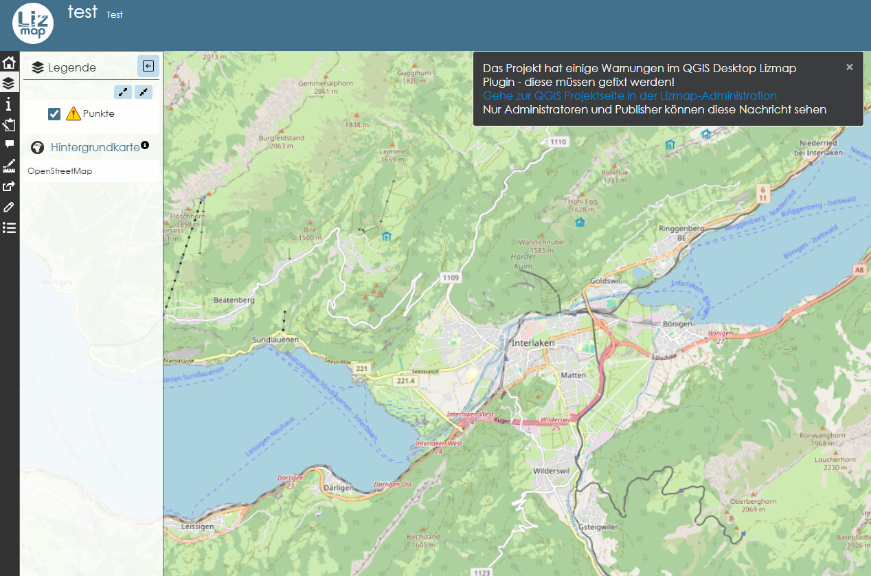

In Lizmap I get:

yes, the yellow exclamation mark gives you a hint that something with your datasource seems not correct. Have you loaded your auth-db into your qgis-server? And have you checked the debug log of lizmap (Administration → Lizmap Logs)

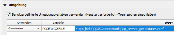

I guess you are referring to this setting – right?
Does it matter if there are several connection entries in the file?
Yes, that is the one! And no, it is made to manage many connections. The service file needs to be placed on the server then as well (preferably at the default location at /etc/postgresql-common/pg_service.conf ). You might have to restart qgis-server to make it read the file (not sure though)
