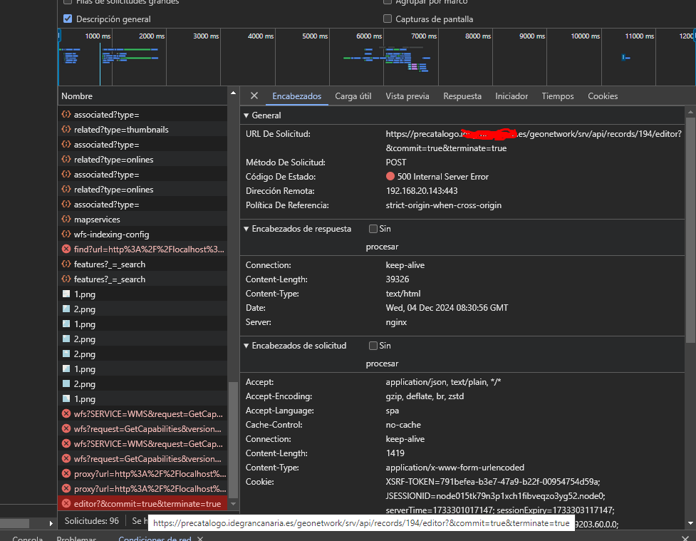

I’m experiencing an issue with my GeoNetwork instance in production. Everything works fine when I access GeoNetwork via localhost or the machine’s IP address (http://192.168.21.108:8080/geonetwork), but when I use my domain (https://domain.com), I cannot save or edit metadata records. The error returned is always a 500 Internal Server Error.

  4. Temporarily disabled CSRF by setting securityMode to NONE in web.xml (same issue persists).
  5. Checked logs on both GeoNetwork and Apache. The error returned is a 500 but with no clear details.
  6. From localhost or IP (http://192.168.21.108:8080), I can create and edit records without any issue.
  7. Ran a curl test:
  • Works fine: curl -X POST http://192.168.21.108:8080/geonetwork/srv/api/records/133/editor?commit=true
  • Fails: curl -X POST https://domain.com/geonetwork/srv/api/records/133/editor?commit=true
Error Details:
*In the browser’s developer tools:
URL: https://domain.com/geonetwork/srv/api/records/133/editor?commit=true

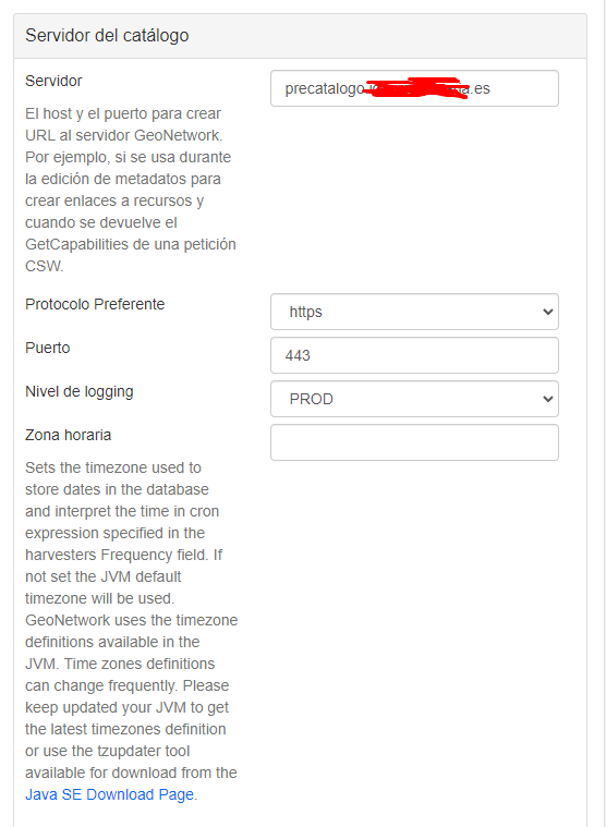

Please check that you have configured the appropriate settings in System Configuration - GeoNetwork opensource to configure the server name / port and protocol using the domain settings.

Buenos días Jose,
Donde debería encontrarse el archivo de Logs? he montando un docker con el geonetwork en uno de los contenedores y haciendo un docker logs no se ve nada relevante.
Todal a web funciona bien, el login funciona bien, solo deja de funcionar al a hora de guardar u nuevo conjunto de datos, servicio, etc.
Tengo en la configuración de sistema el dominio especificado por el cual accedo a la propia web ya:

server.protocol=https
server.host=precatalogo.xxxxxxxx.es
server.port=443
proxy.forwarded.hosts=*
proxy.forwarded.ports=443
Ejemplos de errores queme salen al darle a guardar y salir al crear un servicio, que no me pasa si lo hago con localhost:8080 o con la ip del servidor que esta en mi dominio:
