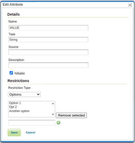

5. Admin UI Support
Enhance the GeoServer admin UI to allow configuring attribute-level restrictions (enumeration, min/max) through the FeatureType editor.
The Feature Type Details table will be made not-editable.
Then, a click on the Edit icon will open a pop-up, to edit the feature type details.
The selection of a specific constraint depends on the type of the attribute.
Example for a “Range” restriction:
Example for an “Options” restriction:

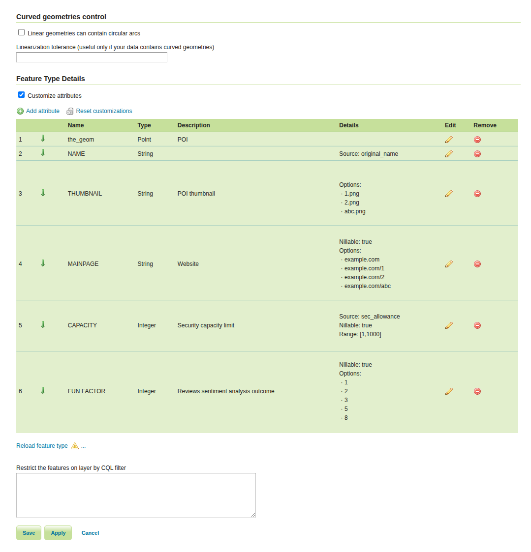

The only hesitations I have are on that table:
  • vertical alignment
  • I assume you want up and down arrows for order?
  • These tables (in several parts of the UI) are getting larger and larger over time :stuck_out_tongue:
Q:Do we need to sort by description or details? If not we may be able to reduce the number of columns (with name and description combined, and type and restrictions combined)
Attribute Type Edit Remove
1 :arrow_up::arrow_down: the_geom
POI
Point :pencil2: :no_entry:
2 :arrow_up::arrow_down: NAME
source: origional_name
String :pencil2: :no_entry:
3 :arrow_up::arrow_down: THUMBNAIL
POI tumbnail
String
Options:

5. Admin UI Support

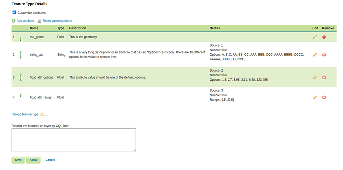

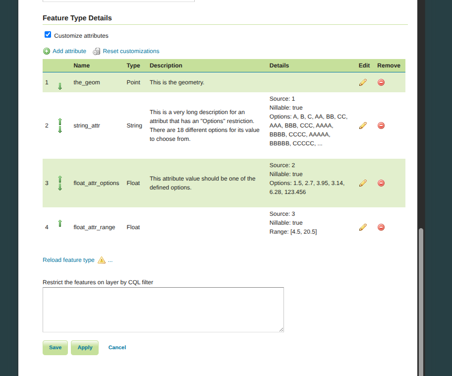

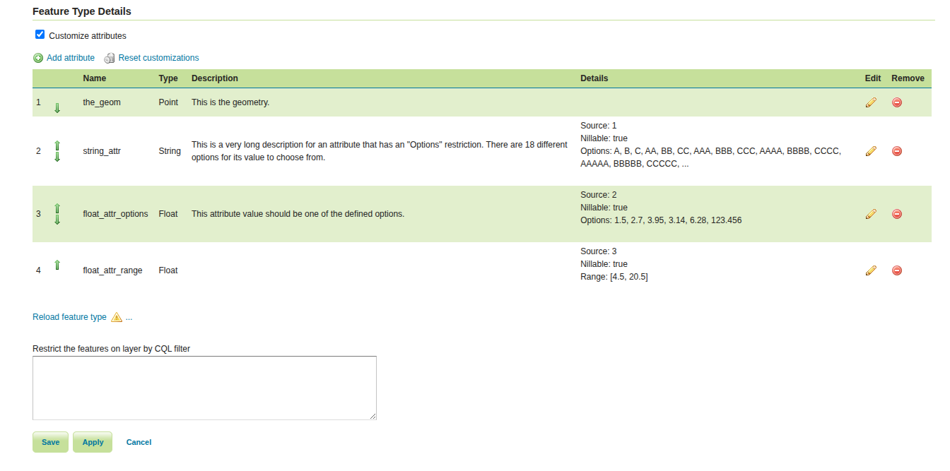

Hello, @jive. Sorry for the late reply.
I’m posting here some examples of the table showing attributes with “heavy” customization, for example when there is a long options list.
Here is a screenshot from a laptop (1920x1200):
And here is one from an emulated iPad:
As you can see, despite the lengthy description and the large options list, the UI does not suffer too much from the amount of information displayed.
As for the sorting by description/details, I’m not sure about the actual need, so I don’t have a strong opinion there.
