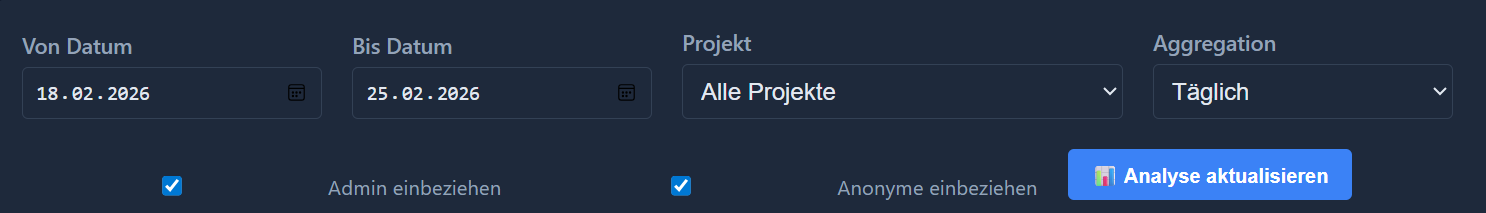

I would like to activate the admin and anonymous users as default. Is this possible?
Peter
It would be very nice to see from which and where a user is coming ( ip adress ) but I know this is only available over the nginx logs.
I think it’s better that the tool remembers the last settings (for administrators and anonymous users). That’s how it is for me too. But I’ve also customized the tool extensively to my needs using AI.
