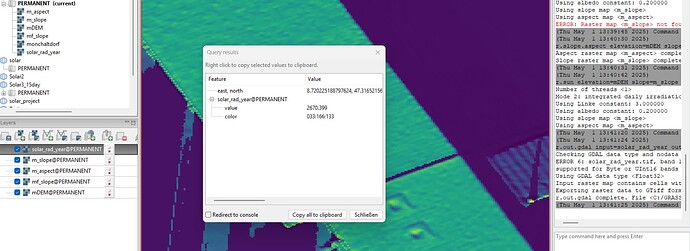

when I work with this code
r.in.gdal input=“C:\GRASS_EXPORT\m.tif” output=mDEM --overwrite
r.slope.aspect elevation=mDEM slope=mf_slope aspect=m_aspect --overwrite
r.sun elevation=mDEM slope=m_slope aspect=m_aspect day=1-365 step=5 glob_rad=solar_rad_year linke_value=3.0 albedo_value=0.2 --overwrite
r.out.gdal input=solar_rad_year output=C:/GRASS_EXPORT/solar_rad_year.tif format=GTiff --overwrite
Location is Zürich. when I have a roof for example, 30°, south, I should get verry roughly 1’200kWh /m2. but Grass Gis show me 2670 (2.670kWh/m2). And this is not possible. Is there a Bug or I understand the Value wrong?
Is this even running? It should be an integer:
Also I am not sure about the albedo and linke values, but they would influence the results.
@annakrat I tried to calculate the total energy in one year with a python. But the calculation takes a very long time.
is there a way to calculate a specific day and interpolate / multiply the annual energy?
my goal is kWh/m2/year. but it seem, taht this can be complicatetd or need much calculation power :wink:
Well, in your first question you suggested an approach to average it from multiple days throughout the year and that seems like a decent approach.
