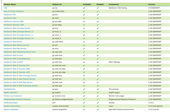

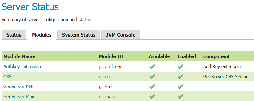

Server status/modules reports the list of modules available in a specific installation, e.g.:
There is a REST API to list them too. As you noted, it’s not always reliable.
Personally I find more useful to go through the output of https://…/geoserver/rest/about/manifest, it reports all jars without relying on module declaration, quick way to find if a certain jar is installed, if there are conflicting versions of a library, or if a certain jar is just missing (sometimes packaging instructions do not include all that’s necessary.
