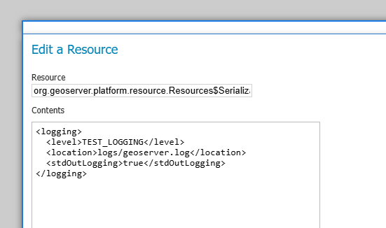

Not sure if this is a bug or if it’s something local, noticed that Resource Browser has recently stopped showing the file name for us but instead a long string.
e.g. org.geoserver.platform.resource.Resources$SerializableResourceWrapper@9f18e426

Yes, you are the first person to mention this :slight_smile:
Let me check if it happens for me on main… confirmed.
I also note that I cannot resize the text area used to show the contents of a file.
