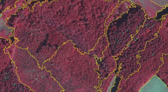

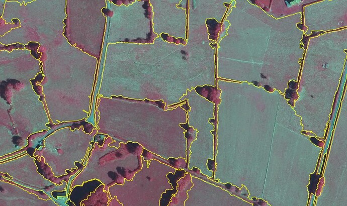

The result is rather interesting for certain areas, in particular crops areas, without too much vegetation. on the other hand, the method does not seems optimal, in particular for forest areas.
I’m taking the liberty to paste some screenshots :
the first SS showing interesting result on crop areas :
A second SS showing the non relevant result on forest areas :
Perhaps for these forest areas, the color/spectral criterion is not relevant. It would be better to generate / integrate texture information? As far as i understood, this GRM OTB module is based only on spectral/colour criterion but not take into consideration texture information.
Are there other orfeotoolbox, qgis, or grass or whatever other segmentation module that takes into account not only the color criterion (spectral) but also texture information?
If this is not the case, should i create some kind of new raster (add a band to my existing color infrared raster) dedicated to texture and/or ndvi information?
