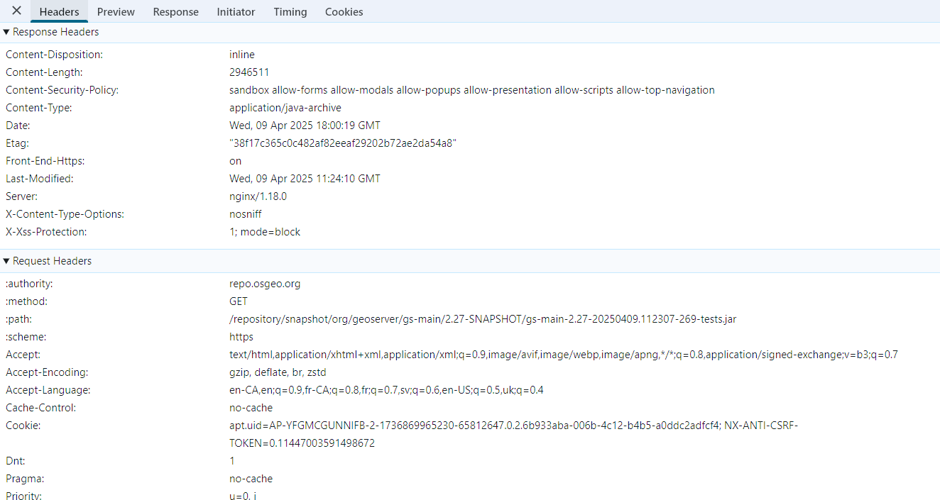

I was trying to build the MapML extension from the 2.27.x branch head today, and I get the following error consistently. I also tried downloading the artifact in the browser and the file size that results is 1.6Mb, although there’s no other indication of error. I think it may be a gzipped / compressed response, but I’m not certain… it doesn’t have a Content-encoding header. When I do a wget on it it retrieves the whole amount but across 2 requests (see response below image). Maybe it’s my network setup? Thanks for any ideas you may have.

I downloaded the artifact with my phone and it the file is 1.52Mb as well, so I think it may be a wrong value in the Content-length header from the repository server.
I was able to download and unzip https://repo.osgeo.org/repository/snapshot/org/geoserver/gs-main/2.27-SNAPSHOT/gs-main-2.27-20250409.112307-269-tests.jar without problem.
Yeah it must be a problem with our network firewall or something. Thanks for your response.
