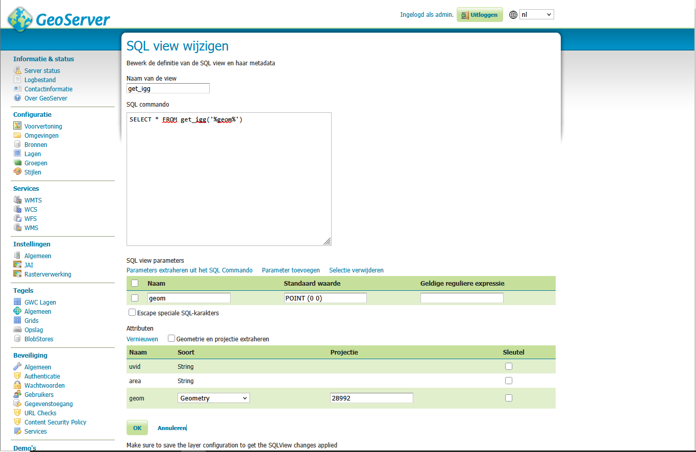

Then I configured a new SQL view in geoserver like this:
Then every time a user clicks on a geometry a XML with the following body structure is send as POST request to the geoserver:
