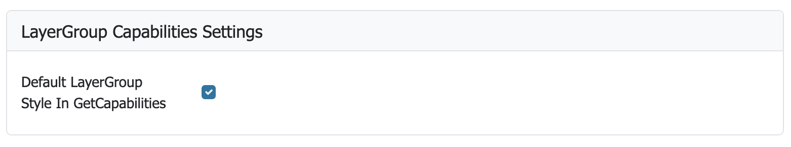

There is a setting to name the default style somewhere in the WMS settings:
Can that help?
I have that option selected, and it seems like it doesn’t make a difference.
obraz
