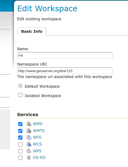

One of the things that can be modified is the workspace itself, in terms of enabling/disabling workspace local services:
However when trying to edit the WFS service (for example) then the following happens:
This seems wrong… I went back into the GeoServer history and the oldest version I have on disk, 2.10, does not show this problem. So it seems like a regression.
Generally speaking, the page seems to be missing the workspace authorizer… however I can tell that 2.10 did not have it, and it was working anyways.

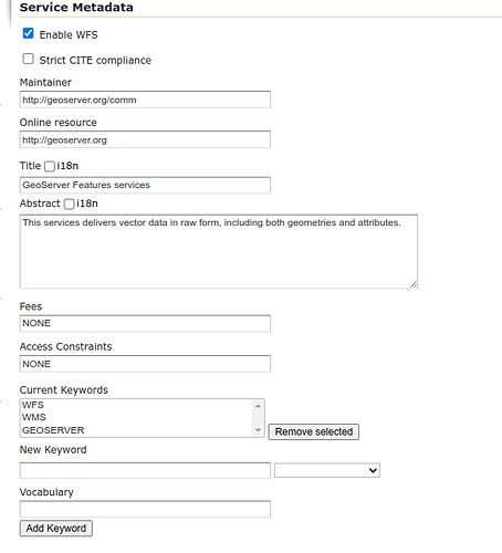

However, after thinking about it a bit more, I grew doubts about it… in that, there are settings in the panel that belong to a per workspace service, like metadata style settings:
And others that related to the stability of the whole server… I’m not sure we want them to be editable by a workspace admin, like service limits (max memory per request), whether or not transactions are acceptable, the size of the WPS thread pools, maybe the OGC APIs conformance classes, and so on.
Addressing this is not trivial, the pages are not designed to have two sets of components for two different levels of accesses. Going there is a major amount of work, each service has a lot of settings, and for some the decision is more nuanced (e…g, the list of supported output formats).

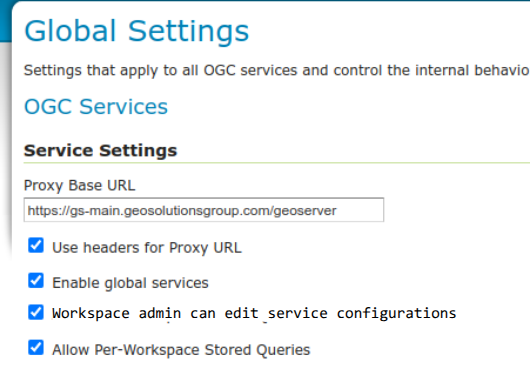

  • We’ll have a flag to allow a workspace admin editing the per workspace service configurations
  • When enabled, the behavior will be to mimic pre-2.14.0, the whole page is editable
  • When disabled, the links from workspace to the service configuration will be disabled and pages not accessible (not even with a direct link)
    To enable/disable this, we could have a GUI flag in the Global Settings:
