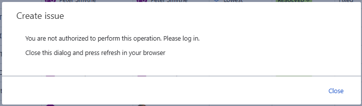

There is still a Jira account creation issue, which I have just replicated. The new account is created and automatically logged in:
yet you can’t create a new issue/ticket:

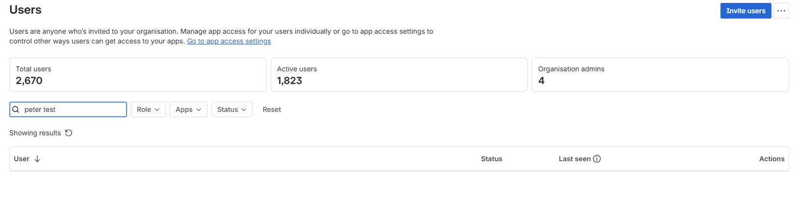

As a Jira admin, I cannot see this new user created:
What is the next step to take to debug this problem? (Hey, other than moving to GitHub issues…)
