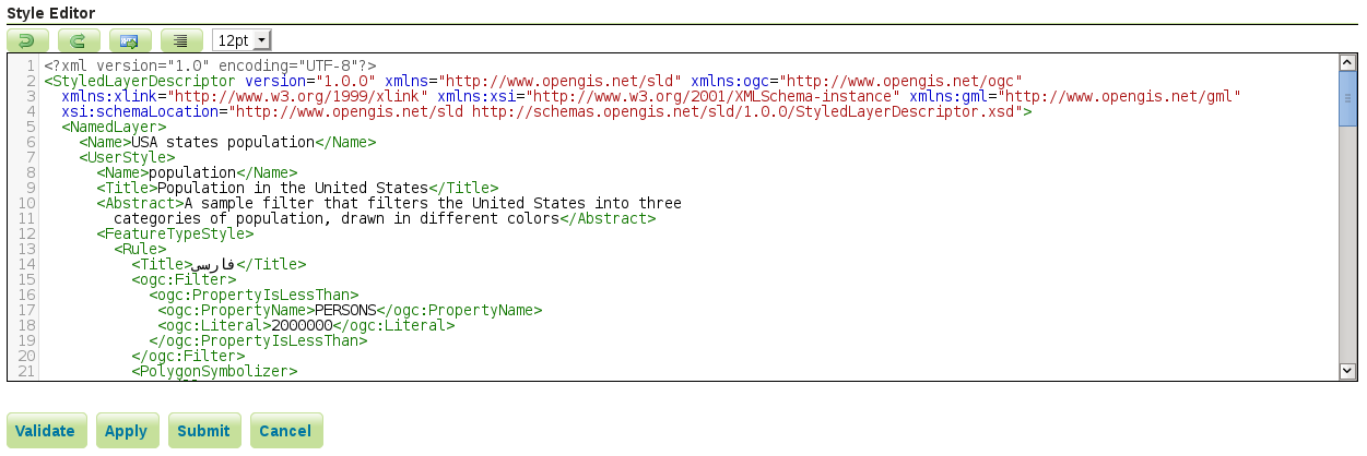

And in answer to your original question, GetLegendGraphic also seems to work on my UTF-8 system (see attached legend).
Kind regards,
Ben.
On 06/11/16 10:45, Ben Caradoc-Davies wrote:
I am using Linux (Debian unstable) with locale en_GB.utf8 (that is,
UTF-8 as the platform encoding). I tested the GeoServer release data
directory (on master (2.11-SNAPSHOT)) by changing the Title of the first
Rule of the population style to فارسی (see attached screenshot).
Wikipedia tells me that this is Farsi for Farsi. I was able save and
load the style, and the USA Population layer preview continued to work
as expected. The GeoServer web SLD editor honours right-to-left display
for the Farsi text.
for the Farsi text.
for the Farsi text.

On 11/11/16 02:20, am2222 wrote:
well.It worked as you said. But is there any way to fix this issue using
geoserver's installation?maybe during installation it configures this
parameter?
Great! Thank you for reporting back. To confirm, you set the Windows environment variable JAVA_TOOL_OPTIONS to "-Dfile.encoding=UTF8"?
The problem is that the GeoServer installer has no business adjusting global Windows settings. This setting might not be suitable for all users because it will change the behaviour of other Java applications. What we can do is document this fix so that users can find the solution more easily.
Kind regards,
Ben Caradoc-Davies <ben@anonymised.com>
Director
Transient Software Limited <http://transient.nz/&gt;
New Zealand
Ben,
thinking out loud, would it make sense to add those settings in the startup
scripts of the windows version?
Cheers
Andrea
On Thu, Nov 10, 2016 at 8:34 PM, Ben Caradoc-Davies <ben@anonymised.com> wrote:
geoserver’s installation?maybe during installation it configures this
parameter?
environment variable JAVA_TOOL_OPTIONS to “-Dfile.encoding=UTF8”?
more easily.
Kind regards,
Director
Transient Software Limited <http://transient.nz/>
New Zealand
Developer Access Program for Intel Xeon Phi Processors
Access to Intel Xeon Phi processor-based developer platforms.
With one year of Intel Parallel Studio XE.
Training and support from Colfax.
Order your platform today. http://sdm.link/xeonphi
Geoserver-users mailing list
Geoserver-users@anonymised.com.382…sourceforge.net
Ing. Andrea Aime
@geowolf
Technical Lead
GeoSolutions S.A.S.
Via di Montramito 3/A
55054 Massarosa (LU)
phone: +39 0584 962313
fax: +39 0584 1660272
mob: +39 339 8844549
http://www.geo-solutions.it
Andrea,
if you mean adding -Dfile.encoding=UTF8 to the JVM command line, I think that is a good idea, but I would defer to the experience of users of the Windows version. Are there use-cases in which it is desirable to leave the file.encoding property unset? Setting this as the default behaviour would likely improve the experience of users with a non-UTF8 default encoding.
Kind regards,
Ben.
On 11/11/16 09:32, Andrea Aime wrote:
Ben,
Cheers
Andrea
Director
New Zealand
Hi,
Yes exactly what I did was setting the Windows
View this message in context: http://osgeo-org.1560.x6.nabble.com/Right-to-left-language-Arabic-Persian-problem-in-SLD-Legend-tp5294270p5295255.html
Sent from the GeoServer - User mailing list archive at Nabble.com.
On Thu, Nov 10, 2016 at 9:41 PM, Ben Caradoc-Davies <ben@anonymised.com>
wrote:
Andrea,
Windows version.
That's what I meant, yes. Unfortunately I also don't have Windows
experience to share...
Eh, I'm not sure.
Cheers
Andrea

Thanks for the confirmation.
