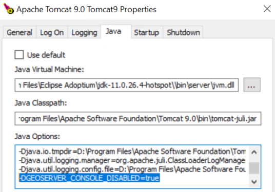

  1. From the Windows Start menu select Apache Tomcat ‣ Configure Tomcat to open Tomcat Properties.
  2. Change to Logon tab, select Local System account, and check Allow service to interact with desktop.
  3. Change to the Java tab, append the lines below to Java Options
    -XX:SoftRefLRUPolicyMSPerMB=36000
    -XX:-UsePerfData
    -Dorg.geotools.referencing.forceXY=true
So my guess is add -DGEOSERVER_CONSOLE_DISABLED=true to the Java Options also.

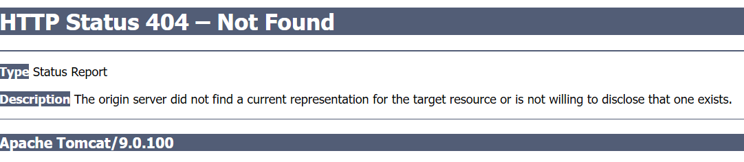

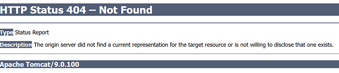

Thank you @jive. I tested the solution you provided, and it turns out that adding -DGEOSERVER_CONSOLE_DISABLED=true to Tomcat’s Java Options is sufficient.
Result:
(ChatGPT confused me with some non-working solutions for the first method… :sweat_smile:)
