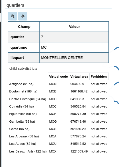

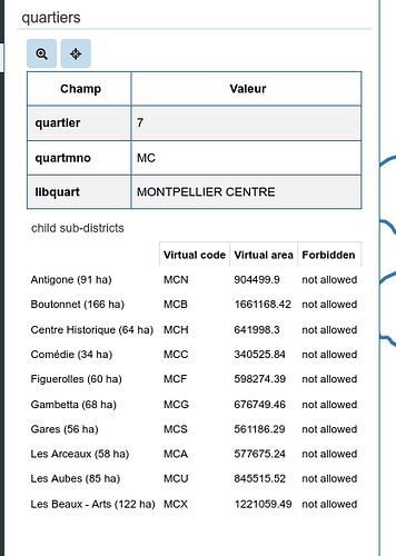

Quick info for 3.9, the “lizmap features table” has been improved
Virtual code and Virtual area are both QGIS expressions for instance. There isn’t any setting in the plugin to add these QGIS expressions as virtual columns. See the documentation for now. Otherwise, if you don’t need these virtual columns, you can still switch to “lizmap features table” in the plugin in the popup section if you have relations associated)

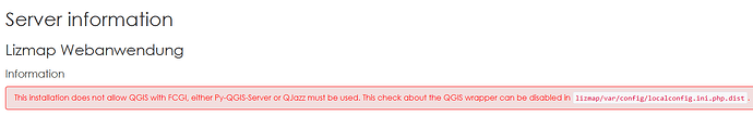

Under nginx with Py-QGIS-Server I was able to install both versions and at first glance everything looks fine.
Without the Py-QGIS server under Apache I could not use version 3.9.
I probably have to change this block in the localconfig.ini.php.dist file:
[qgisWrapper]
; If off, FCGI is not allowed, only Py-QGIS-Server or QJazz
; allowFcgi=off
But how?
With ; allowFcgi=on it doesn’t work and if I delete the block completely it doesn’t work either
You need to un-comment the block, look at colorization on Discourse, it’s INI file : INI file - Wikipedia

Thanks for the feedback. It works.

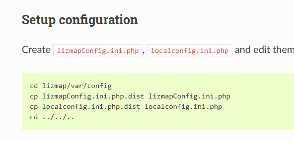

I had changed it that way, but only in the localconfig.ini.php.dist and then it is not enough if I only execute the installer.php afterwards.
localconfig.ini.php.dist is just a dummy file for the example, as you should have localconfig.ini.php for “your” settings.
@etrimaille Thanks, it was in the backend and I didn’t think any further
The file is also copied during the first installation

Yes, indeed, it must be modified in your localconfig.ini.php. But this file might be old, as you might have done upgrade for many months, so you don’t have this “new” section in your “old” localconfig.ini.php.
localconfig.ini.php.dist is quoted as example to have this new section (as coming from the ZIP 3.9).
This surprised me at first, as I install every update from scratch from the ZIP file.
However, I back up before the update and restore after the installation.
And I see that the file “localconfig.ini.php” is included in the backup. So I must have taken it with me over various versions.
I will update it and only apply the changes.
