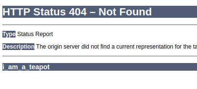

When using osgeo3:

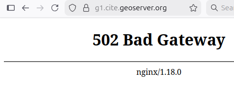

When using osgeo8:

When using osgeo3:
When using osgeo8:

I noticed that there is a docker on osgeo3:
docker ps
CONTAINER ID   IMAGE                                         COMMAND                  CREATED        STATUS                  PORTS                                         NAMES
530983e6a73f   geoserver-docker.osgeo.org/geoserver:2.27.0   “bash /opt/startup.sh”   4 months ago   Up 4 months (healthy)   0.0.0.0:8082->8080/tcp, \[::\]:8082->8080/tcp   cite_geoserver-wfs20_1
d15d252225af   geoserver-docker.osgeo.org/geoserver:2.27.0   “bash /opt/startup.sh”   4 months ago   Up 4 months (healthy)   0.0.0.0:8083->8080/tcp, \[::\]:8083->8080/tcp   cite_geoserver-wfs11_1
15ac5f40a914   geoserver-docker.osgeo.org/geoserver:2.27.0   “bash /opt/startup.sh”   4 months ago   Up 4 months (healthy)   0.0.0.0:8081->8080/tcp, \[::\]:8081->8080/tcp   cite_geoserver-wms_1
29067038b636   geoserver-docker.osgeo.org/geoserver:2.27.0   “bash /opt/startup.sh”   4 months ago   Up 4 months (healthy)   0.0.0.0:8086->8080/tcp, \[::\]:8086->8080/tcp   cite_geoserver-wcs10_1
358c1830a413   geoserver-docker.osgeo.org/geoserver:2.27.0   “bash /opt/startup.sh”   4 months ago   Up 4 months (healthy)   0.0.0.0:8085->8080/tcp, \[::\]:8085->8080/tcp   cite_geoserver-wcs11_1
8ea756258b04   geoserver-docker.osgeo.org/geoserver:2.27.0   “bash /opt/startup.sh”   4 months ago   Up 4 months (healthy)   0.0.0.0:8087->8080/tcp, \[::\]:8087->8080/tcp   cite_geoserver-gpkg12_1
2a6b74841a20   postgis/postgis:17-3.5                        “docker-entrypoint.s…”   4 months ago   Up 4 months (healthy)   0.0.0.0:5555->5432/tcp, \[::\]:5555->5432/tcp   cite_postgres_1
But docker is not running on osgeo8
docker ps
In the notes about the setup of cite-geoserver there is nothing about how to start docker
Let me know when done
Right now I have DNS pointing to osgeo8, Please can someone start docker properly
I will turn it back to osgeo3 in about an hour, which will be shut down soon, which makes the osgeo8 starting docker urgent.
