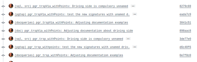

Week 2:
We decided that we are going to slightly change the way we include whatever is happening on the pgRouting main repo.
For that matter when I did to make that change happen, is I went and merged your branches with pgr/develop and pushed. Solved conflicts, and the PR looks cleaner for us to review. Except for @wifi 's PR.
@wifi you forced push
Please for the sake of the program
  • try not to force push.
  • Please merge your (valid) PR and close your (invalid) PR’s before we start our meetings.
  • Do not delete any branch you create.
  • List all your good and bad PR on your reports.
    • add a comment on the bad PR of why you are closing for example:
      • "Closing in favor of PR #number
      • Force pushed and now I cant recover, will start over on PR #number
      • Too many changes in one go, and now I am getting too many errors, will work it out slower on PR #number
Even that now your branch has all the commits of pgr/develop, They still show on your PR.
So please start a new week-2-king-minimum-ordering-try2 branch from scratch:
git fetch origin
git checkout wifi-2025
git switch -c week-2-king-minimum-ordering-try2
Regards

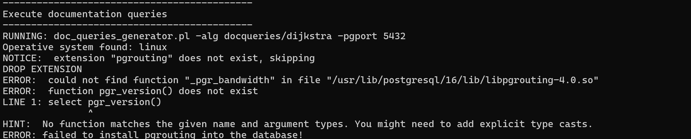

Hello everyone ,
I’ve reached this position, but I’m currently stuck. Could someone please guide me on what steps to follow next to reach the stage where I can see SQL results whether it’s passes or failed?
Best Rgards,
Saloni Kumari
Same, I’m stuck here too. How should we proceed next?
I dont see command, to replicate your output. Please dont post images, do copy paste and sorround with triple back tick
That is what I see while compiling your try3 branch.
bash run.sh
pgRouting VERSION 4.0.0
[ 27%] Building CXX object src/dijkstra/CMakeFiles/dijkstra.dir/dijkstraVia_driver.cpp.o
/home/vicky/pgrouting/pgrouting/cvvergara/src/metrics/metrics_driver.cpp:41:10: fatal error: c_types/graph_bandwidth_rt.h: No such file or directory
   41 | #include "c_types/graph_bandwidth_rt.h"  // <- Your actual result type
compilation terminated.
/home/vicky/pgrouting/pgrouting/cvvergara/src/metrics/metrics_process.cpp: In function ā€˜void pgr_process_metrics(const char*, GraphBandwidth_rt**, size_t*, char**, char**)’:
/home/vicky/pgrouting/pgrouting/cvvergara/src/metrics/metrics_process.cpp:76:13: warning: unused variable ā€˜start_t’ [-Wunused-variable]
   76 |     clock_t start_t = clock();
/home/vicky/pgrouting/pgrouting/cvvergara/src/metrics/metrics_process.cpp:61:17: warning: unused parameter ā€˜edges_sql’ [-Wunused-parameter]
   61 |     const char* edges_sql,
[ 38%] Building CXX object src/pickDeliver/CMakeFiles/pickDeliver.dir/vehicle.cpp.o
I can imagine that you have the following on your run.sh:
QUERIES_DIRS="
metrics
ordering
Please leave like:
QUERIES_DIRS="
TAP_DIRS="
After doing so , this is what I got :
bash run.sh
Compiling with G++-
Execute documentation queries
Execute tap_directories
pgTap test all
NOTICE: database "___pgr___test___" does not exist, skipping
5432
5432
~/GSoC-pgRouting/tools/testers ~/GSoC-pgRouting
NOTICE: installing required extension "postgis"
ERROR: could not find function "_pgr_bandwidth" in file "/usr/lib/postgresql/16/lib/libpgrouting-4.0.so"
Could you please tell me once which all file we need to make for our algorithm , to see whether it passes or fails ?
Best Regads ,
Saloni Kumari
Testing is going to addressed with more detail on week four meeting.

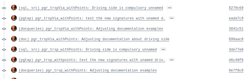

I went to see your week-4-pr
Why?
you made a force push:
I told you not to make force pushes
and not only that, you updated the repository with develop contents
In a previous communication (somewhere) I mentioned not to force push
And in our last meeting we told you not to update with pgrouting development.
I will consider that you were on the meeting at very odd times for your timezone.
Please dont do it again.
I will try to fix as much as I can specially for the pull request.
@wifi
Sorry for some reason could not fix the PR to remove my commits.
Please read the instructions first and then follow them
So you will need to start over:
upstream = GSoC main repo
git fetch upstream
git checkout upstream/wifi
git switch -c week-4  week-4-king-minimum-ordering-try2
now I can see a lot of commits on the week-4-king-minimum-ordering branch
You need to recover them:
git cherry pick  3a1d19e .. 0dae108
or maybe:
git cherry pick  0dae108 .. 3a1d19e
Not sure because the just to start a new week is the last commit and should be the first one
I got those commit numbers from the PR:
 Get run.sh to work on my macOS                          0dae108
 Adds ordering driver and process implementation         84acd3f
Adds basic structure of test for king and minimum degree d8eb518
just to start the new week                               3a1d19e
If the sequence style did not work then do each one in order: (reverse of what is shown on the PR I would think because the "just to start the new week " would be the first one.
git cherry-pick 3a1d19e
git cherry-pick d8eb518
git cherry-pick 84acd3f
git cherry-pick 0dae108
After recovering them push and make the PR with the new branch.
Please DO NOT MERGE with pgr/develop
Thank you for your guidance, @cvvergara .
I got through my problem! :smiley:
