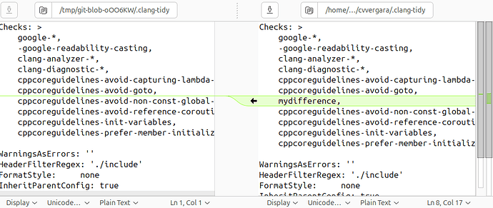

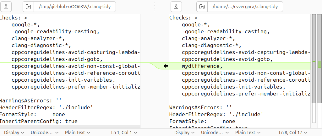

We need to fix everything:
git checkout upstream/develop
Edit .clang-tidy
more .clang-tidy
Checks: >
    google-*,
    -google-readability-casting,
    clang-analyzer-*,
    clang-diagnostic-*,
    cppcoreguidelines-*
WarningsAsErrors: ''
HeaderFilterRegex: './include'
FormatStyle:     none
InheritParentConfig: true
FormatStyle:     none

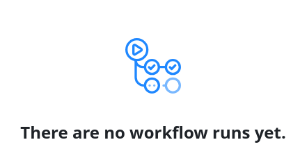

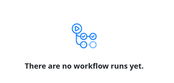

Hi all,
Some of the forks of the main repository are missing actions:
For example shows
make sure the actions run in your fork.
Probably you need to activate the github actions

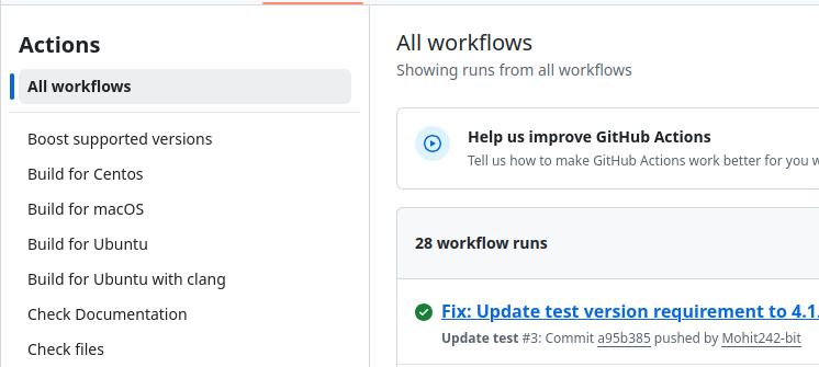

Second step
At the top of the PR I will click the link of the branch that wants to be merged
I will mark it as draft and wont worry to check it if the actions are not running on your fork if I see something like this.

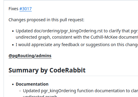

I will proceed to the third step If I see this (or something similar) :
(Don’t forget about the first step)

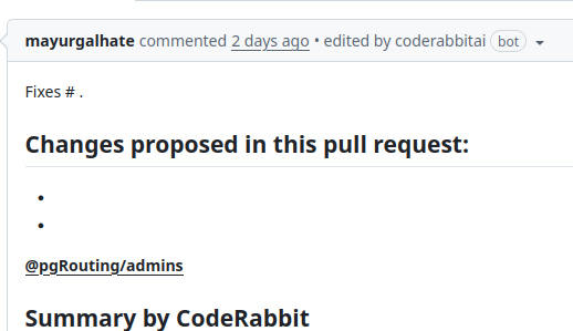

Third step
I will mark as draft if I see something like this on your PR message
If I see your personal comment for example like this one I will proceed to review:

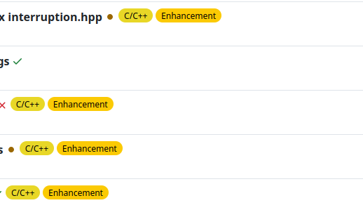

Marked as almost ready to be merged
There are some PR that are were reviewed before this rule that have the following labels:
Maybe they are missing:
  • The actions running in the fork
  • and/or The personal PR message
For pgRouting point of view:
  • The PR are almost there
  • They will be merged
But if they are not merged yet I will follow the steps above and fall into the category of the rest.

The conflicts have started:
Please fix them.
You can use the browser :slight_smile:
But be very careful.
otherwise do:
git fetch upstream
git checkout upstream/develop the_offending_file.ext
git difftool -t meld -y HEAD
That will show on the left whats on upstream develop and on the right your contents
My difference is a mistake, so I can remove it :slight_smile:
If you haven’t installed meld, please do, I use it all the time.
I don’t like to fix on the browser, because, well I always mess up, I mess up a little less using meld.
Regards

  • You need to have the CI (in our case gihub actions) and see them often
  • Make a PR when everything pass
  • mark it ready for review when everything passes
